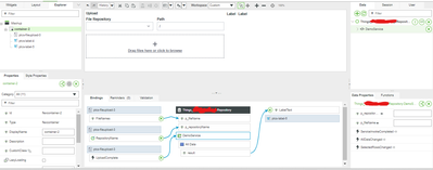

Hi Arun,
Thanks for your answer!
Here i need is that, need to create a folder on selection of a file using file upload widget, with the selected filename and split the files into multiple and need to save it in the created folder itself
Hi @Keerthivarman ,
I hope this below sample code may helps you in after uploading a file from File Upload - Widget it will create the a folder based on a selected file name and upload that file in that created folder.
var repositoryName = p_repositoryName;
var renamedFolderName = '';
if (p_fileName != null && p_fileName != undefined && p_fileName != "") {
try {
var SplitPath = p_fileName.split(".");
renamedFolderName = SplitPath[0];
} catch (e) {
renamedFolderName = 'NewFile';
try {
try {
Things[repositoryName].CreateFolder({
path: renamedFolderName /* STRING */
//logger.info("renamedFolderName - " + renamedFolderName);
} catch (e) {}
Things[repositoryName].MoveFile({
targetPath: '/' + renamedFolderName + "/" + p_fileName /* STRING */ ,
overwrite: false /* BOOLEAN */ ,
sourcePath: "/" + p_fileName /* STRING */
//logger.info("Target - " + renamedFolderName + " ; Soruce Path - " + p_fileName);
result = p_fileName + " - Successfully uploaded into the folder of " + renamedFolderName;
} catch (e) {
result = "Error in File Upload in New Folder - See Script Error Log for more details.";
} else {
result = "Please Enter Value In Folder Name";
Mashup Binding:
I'm not clear about the req split files into multiple. If you are looking to Extract the Zip/Archive means you can use the Repository Service of ExtractZipArchive/ExtractArchive in this case you don't need to create any seperate folder.
