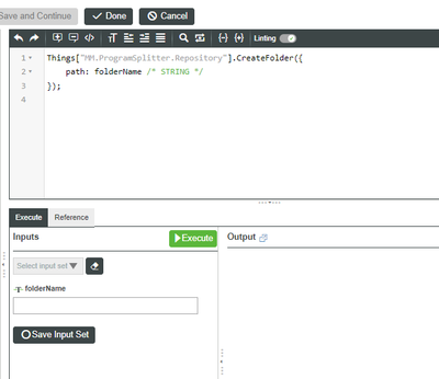

i've created a service for creating folder in the repository, how can i get the created folder name in the output as string/text?

Hi @Keerthivarman ,
Based on my understanding you are trying to create new folders in repository using service once it done you need the STRING result in same service. In that case kindly find the smaple code attached, if not kindly explain more in your use case here.
var repositoryName = "DVC_Prod_ImageRepository";
if (p_folderName != null && p_folderName != undefined && p_folderName != "") {
	try {
		Things[repositoryName].CreateFolder({
			path: p_folderName /* STRING */
		result = p_folderName + " - Folder Created Successfully!";
	} catch (e) {
		result = "Error in Folder Creation - See Script Error Log for more details.";
} else {
	result = "Please Enter Value In Folder Name";
