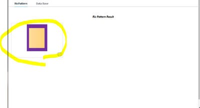

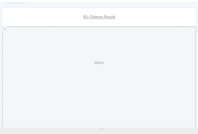

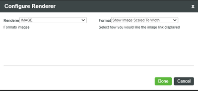

Hi Developers,
I added a "valuedisplay" widget to display image dynamically but image size is small even though I configured the setting to "show image scaled to width".
Could anyone tell me on how to expand an image in the widget ?

@Yoshihiko.N You can try increasing the container size for the value display widget by giving the MaxHeight and MaxWidth properties. Alternatively you can use image widget to display images on mashups.
