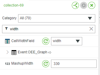

I want to set CellWidthField of the collection widget by screen resolution.
Scenario is
  • get client screen resolution (1920,1366) and send to service
  • service output with data and width
  • CellWidthField select width from output service
And i tried using CSS to set MashupWidth but still can't set width.
Thank you for your help

If you want the collection cell to be the whole width of the container, not matter the width, set these settings like this:
View: Flow,
MashupWidth: 9999
FlowLayoutGravity: Expand
The Expand on the MashupWidth will act as a minimum width OR if it's something huge like 9999 it will span the whole width of the container.

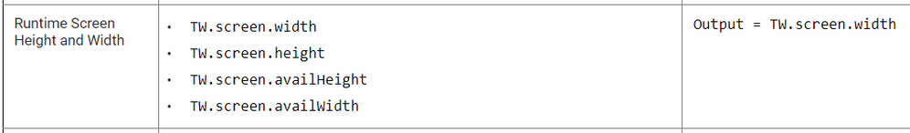

Just wanted to post an update here as I just realized I missed the most obvious thing in the PTC help center link from my previous post which clearly states that the following should be supported.
But I can at least not get the "TW.screen.width/TW.screen.height" to work.
Perhaps it would be good to open a support ticket for this.
