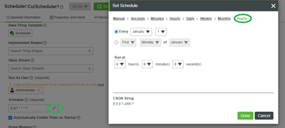

You can create a scheduler entity first. After you save that entity, click the pen mark like the follwing screenshot. There will be a popup window where you can configure sheduler every year/month/day/hour...

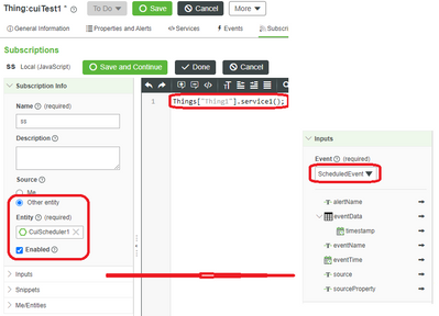

Next step you need to prepare you own thing service which send the user email. Let's call <thing1.service1>. And create a thing subscription which will be trggered by scheduler and perform <thing1.service1>. Settings as below picture.
hi @wcui
i have done in single user sent e-mail (day,week,month,year) but I need multiuser configuration,
N number of user and N number CREON value ,also how is it create manually?
this image in same CRON value in  ALL user right ?
but different Cron value and different user and sent mail common but content is different
