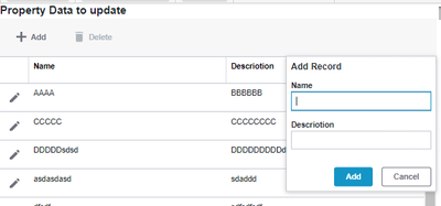

Excuse me, can we input data manually at mashup screen in grid table and storage in Thingworx. Thank you
Hi @DR_10558933 ,
Yes, you can able to "RowAddButton" to add new rows in grid and use grids "isEditable" property to enable edit option in grid and select the editable columns in "ConfigureGridColumns" to update your grid data and then based on the "EditCompleted" event you store the grid's "EditedData" infotable data into your storage.
