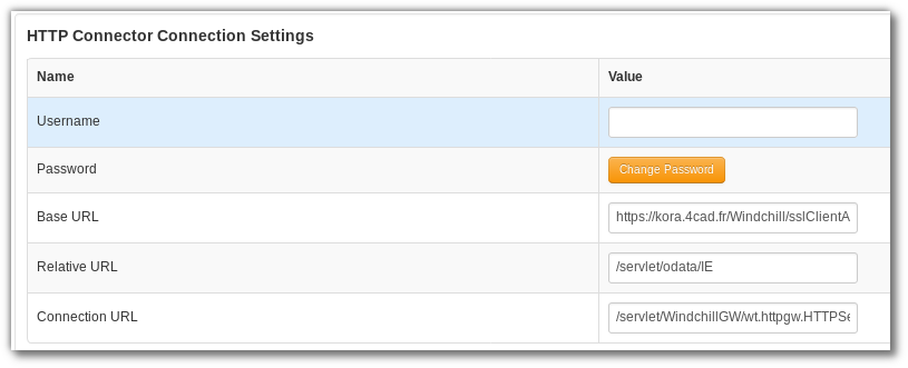

My configuration :

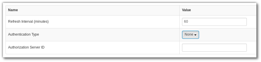

No Auth ( driven by SSL certificate... )
Connection definition
Base url is https://kora.4cad.fr/Windchill/sslClientAuth
Also added
But when I try to use the "validate connection" service, 403 error, and in PDMLink log

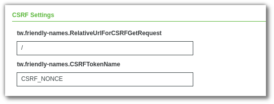

Ok I think I understand what's going on.
PDMLink's REST API is protected of CSRF attacks, so you have to use a  specific header in the request.
Only the POST requests, GET requests don't need it.
I thought that the connector's CSRF settings would do this, but it doesn't
I checked the network exchange with wireshark, no CSRF token.
So it fails...
Now I need to find how to set this token, maybe in the GetCustomHeaderParameters, but I need to make a call to PDMLink to retrieve the token !

I am trying the same configuration for ODataConnector, and I learned that a Javascript is required to set wt.effectiveUid (or else there is no remote user, and you get code 403). In the GetCustomerHeaderParameters service on the connector, add this script:
var sessionQueryParam = "wt.effectiveUid";
var Language = Resources["CurrentSessionInfo"].GetCurrentUserLanguage();
var params = {
infoTableName : "InfoTable",
dataShapeName : "NavigateCustomHeadersDataShape"
var result = Resources["InfoTableFunctions"].CreateInfoTableFromDataShape(params);
var CurrentUser = Resources["CurrentSessionInfo"].GetCurrentUser();
params = {
tableName: "GenericConnectorConnectionSettings" /* STRING */
var configTable = me.GetConfigurationTable(params);
var row = configTable.getRow(0);
var authType = row.getStringValue("AuthenticationType");
if("None".equals(authType)) {
var camelHttpQuery = sessionQueryParam + "=" + CurrentUser;
row = {"Accept-Language" : Language, "CamelHttpQuery": camelHttpQuery };
} else {
row = {"Accept-Language" : Language };
result.AddRow(row);
With this addition, I am able to successfully execute the ValidateConnection test. I am working now on issues with the GetEndpointList service, but I get authenticated.

Setting Relative URL to: /servlet/odata/IE restricts the connection to the IE endpoint. Using /servlet/odata will allow access to all endpoints.
You also need Windchill 11.0 M030 to be patched to at least CPS06 for the REST services to be up to date. Remember that you need to re-apply the Windchill Extension for Navigate after completing the CPS patch.

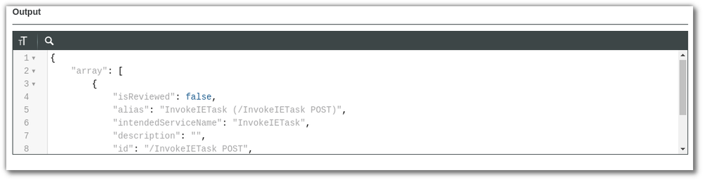

However, GetEndPointList works... in the new composer :-)
Last update, I can create the service, calling it raise an error
Unable to Invoke Service InvokeIE on ODATAConnector2 : Your route exchange has failed. Service operation failed [https://kora.4cad.fr/Windchill/sslClientAuth/servlet/odata/IE/InvokeIETask?wt.effectiveUid=Administrator] with status [ - A potential security problem was detected. Refresh the page and try again. If the problem persists, contact your administrator.]
But this comes from the CSRF_NONCE header, so I can fix it I guess.I'll post the final result
Here's a clarification I received from R&D:
The relative url should be /servlet/odata only. Any domains like IE, ProdMgmt, etc should be set as values of the ServiceRootRelativeURL configuration. By setting the relative url that includes the domain name in it, you are restricting the connector to expose endpoints only in that domain. The expected protocol is to list all domains in the ServiceRootRelativeURL configuration, even if it's just one domain like IE in this case.
