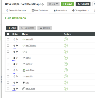

Use this arrow in DataShape FieldDefinition to set the order of fields. In the backend, it will set an ordinal number for fields
Here I moved hasChildren field to position 1

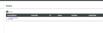

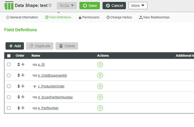

I had Data Shape like this:

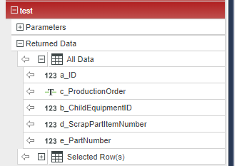

on Mashup side it looks like this:
the question is how can I keep the same order on mashup side?

Hi @JK_10565232
In Mashup DesignTime, field names will be sorted alphabetically. We don't have control over that.
It just makes mapping easier during design time it doesn't impact Mashup Runtime sorting.
