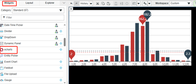

企业微信截图_17043543548507.png企业微信截图_1704353311259.pngI tried to develop 3Decharts on thingworx using Eclipse, but it failed, and there is no detailed tutorial on the internet, or is there any other way to make 3D pie charts in thingworx?

Hi @Snoopy_hu.
Unfortunately, nothing has changed.  There are no plans to add this functionality to the core ThingWorx product, and no examples are available.
You actually have 2 choices for addressing this need:
  1. Create your own widget extension with the required libraries using these instructions
  2. Engage with our global services consultants for developing the extension for you.  You can work through the Sales team for making the arrangements
Regards.
--Sharon

I didn't find an example of making a 3D echarts chart. is there any example of using Eclipse to create a 3D pie chart?
slangley
(To:Snoopy_hu)
Hi @Snoopy_hu.
Regards.
--Sharon
