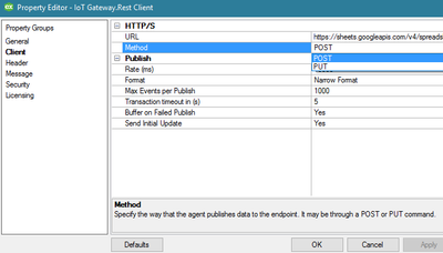

 I have a question/doubt about IoT Gateway's REST Client:
How can I make a GET request from REST Client in order to retrieve some data from an external API (e.g. Weather, web application, etc)?.
As you know, it only supports PUT & POST method and it's fine but what about if I want to connect to Google Maps, Open Trivia  or AccuWeather  and retrieve/handle some values??
Even, I have a Google sheet's script deployed as web application listening external calls to log data in my sheet and I just need a simple GET request to achieve it but I can't find a way to do it from IoT Gateway module. My URL to get this is:
"https://script.google.com/macros/s/ SCRIPT_ID/exec?temp1=1234&level=122&pressure=88"
What would be the procedure or module to achieve it?
Thanks in advance for your prompt reply and help,
Saludos!
I suggest reviewing the IoT Gateway User Manual, available here.
In short, the IoT Gateway is a plugin that is used in Kepware to publish tag values (through different methods, like REST or MQTT).
Any sort of custom coding is not its intended use-case (generally speaking).
ThingWorx on the other hand is an Industrial IoT Platform (description here), where you can build applications for a variety of use-cases.
The use-case you shared is something that ThingWorx would help you to do, as it contains something ContentLoader snippets that allow you to execute GET,POST,PUT and then use it in Javascript to your liking.
ThingWorx and Kepware are very different, though it is worth mentioning that Kepware can be integrated in ThingWorx out of the box, via a native integration capability (you can receive tag values in ThingWorx directly, can modify a Kepware configuration directly from TW).

Hi Gavp,
If you look in the first line of my last comment, I added a link to the IoT GW User Manual there. Everything related to the IoT GW, what it can do, etc, is in there.
The REST client is designed to send data directly via PUT/POST since these are the only HTTP verbs that modify the targeted resource.
GET on the other hand is used by design to get a resource representation, and while it is correct it can be used in a first step to get an OAUTH token, that worklow is not supported.
