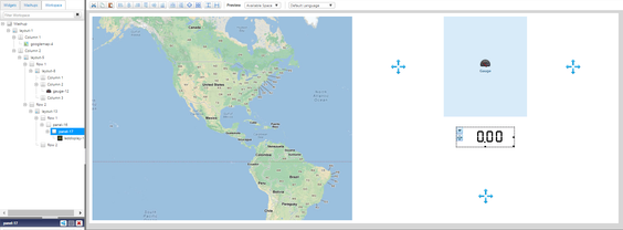

From the above pics, you could see that the positions of widgets on the right side remain unaltered when screen resolutions are changed. Here, i put a layout widget ,then i put the panel on the panel over the layout portion and then put some widgets. The effect on widgets remains the same with a single panel on the layout portion. But, i wish to make the screen more responsive so that the widgets could get positioned responsively upon screen resolution changes.

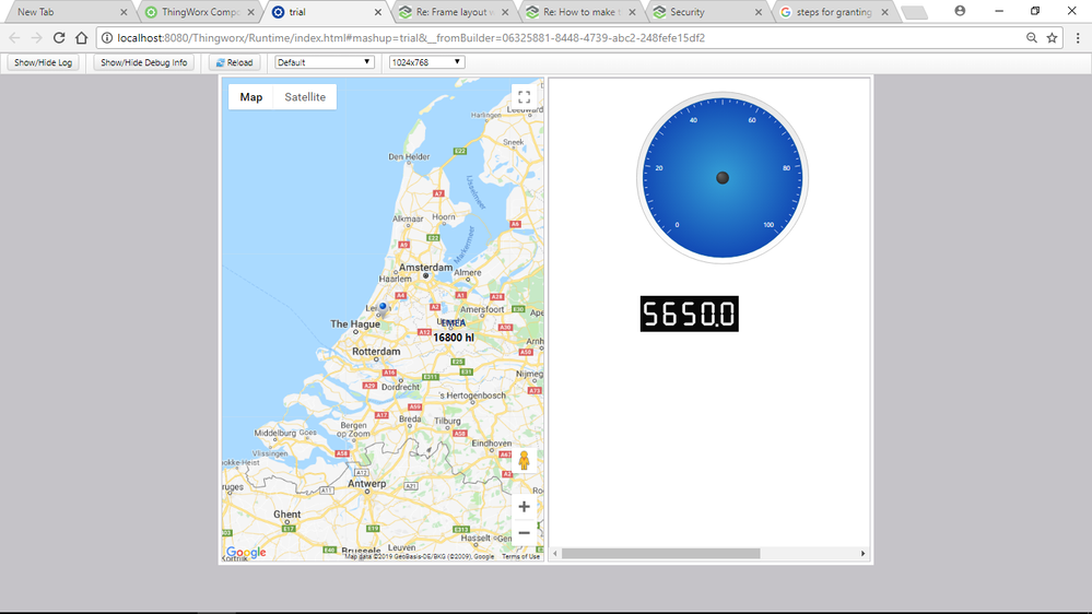

I have created an example using the widgets you have used.

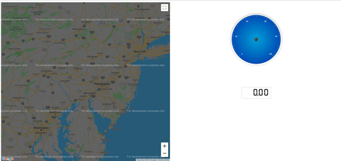

My mashup is quite responsive. I have take two screenshots of it at different zooms. I have done this through the use of the layout widget and a panel on a panel.
Zoom1Zoom1Zoom2Zoom2
The first layout is used to divide the page by half, the second layout is used to divide the right hand side etc. I have placed the gauge directly on the layout without a panel. This allows the gauge to be responsive.
I have then placed a panel on a panel for the LED display. To allow the panel on panel approach to be more effective, you have to reduce the second panels' size so that it boarders the widget(s). I have also taken a screenshot of this, note the size of the second panel to the widget (it is almost the same size).
