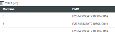

Lets say my datashape; PPA.AllData contains: "DMC" and "Machine" properties/columns.
My datashape:
But my CSV file contains the four columns as in the code below.
When I run the following code:

 I only get the columns that are in my datashape in the result:
And so you don't even really need to have all of the columns in the "columnMapping".
Just put the ones you have in your datashape.
Jens
