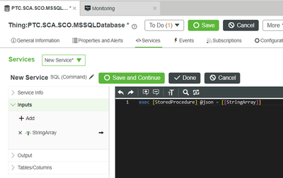

Above logic should be written in javascript service? If yes, How can i call below exec SP here?
exec [StoredProcedure] @json = [[StringArray]]

Hello @Vipul_Oswal,
Let me clarify it a little bit:
Regular thing: Javascript Service:
let jsonString = InfoTable.toJSON();
let stringArray = jsonString.rows;
Things["YourDatabaseThing"].UpdateDataBaseWithJSON({
      StringArray: stringArray
SQL thing: SQL Command Service:
