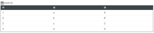

Example for ROW to COLUMN transpose:
// CreateInfoTableFromDataShape(infoTableName:STRING("InfoTable"), dataShapeName:STRING):INFOTABLE(transpose_ds)
let sourceTable = Resources["InfoTableFunctions"].CreateInfoTableFromDataShape({
    infoTableName: "InfoTable",
    dataShapeName: "transpose_ds"
let newEntry = {
    f1: '1',// STRING
    f2: 'a',// STRING
    f3: 'A'// STRING
sourceTable.AddRow(newEntry);
newEntry = {
    f1: '2',// STRING
    f2: 'b',// STRING
    f3: 'B'// STRING
newEntry = {
    f1: '3',// STRING
    f2: 'c',// STRING
    f3: 'C'// STRING
newEntry = {
    f1: '4',// STRING
    f2: 'd',// STRING
    f3: 'D'// STRING

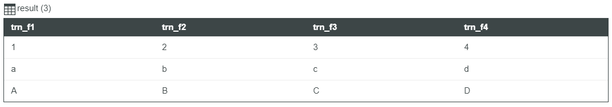

let transposedTable = Resources["InfoTableFunctions"].CreateInfoTable();
var stRecordCount = sourceTable.length;
var transposedTableFields = [];
for(var f = 0; f < stRecordCount; f++){
    var fieldName = 'trn_f' + (sourceTable.rows[f].f1);
    let newField = {
        baseType: 'STRING'
    transposedTable.AddField(newField);
    transposedTableFields.push(fieldName);
for(var i = 0; i < stRecordCount; i++){
	var sourceRowData = sourceTable.rows[i];
    /** convert as colum data **/
    var row = 0;
    for(var rowValue in sourceRowData) {
        var transposed1stFieldName = transposedTableFields[i];
        if(i == 0){
            var dataEntry0 = {};
                dataEntry0[transposed1stFieldName] = sourceRowData[rowValue];
            transposedTable.AddRow(dataEntry0);
        }else{
            transposedTable.rows[row][transposed1stFieldName] = sourceRowData[rowValue];
            row++;
result = sourceTable;
result = transposedTable;
Source Data:
Transposed Data:
Hope this helps.
