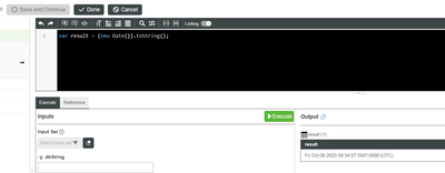

Hi @MM_9023322
If you want to get the Thingworx server timezone you can get using the below method.

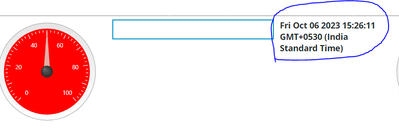

To get the client browser timezone
timevalue = new Date();
Output = timevalue.toString();

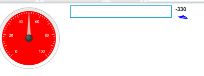

To get the client browser timezone difference, you can use "getTimezoneOffset()" in the expression function to get the timezone offset value
Output = timevalue.getTimezoneOffset();
