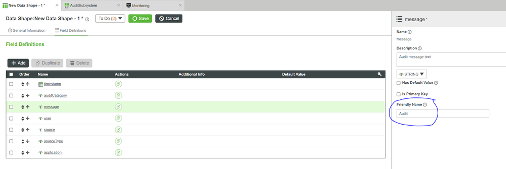

I need to access following information from ThingWorx Number of users logged in and their time.
For this I am trying following service: "QueryAuditHistoryWithQueryCriteria" following ptc article:
https://support.ptc.com/help/thingworx_hc/thingworx_8_hc/en/index.html#page/ThingWorx/Help/Composer/System/Subsystems/AuditSubsystemSearchAuditData.html#
Could you all please help me provide correct json input as filter I should provide for same.
Attaching screenshot for same.
json query:
"filters": {
"type": "LIKE",
"fieldName": "Audit",
"value": "Login%"
Error:  Unable to Invoke Service QueryAuditHistoryWithQueryCriteria on AuditSubsystem : com.thingworx.common.exceptions.DataAccessException: [1,018] Data store unknown error: [Error occurred while accessing the data provider.]

Hi @Siddharth_Jhs
FieldName displayed in the result is a DataShape Friendly name. You can find the actual fieldName by creating DataShape from the result

Hi @Siddharth_Jhs
Try below query
    "filters": {
        "type": "And",
        "filters": [
                "fieldName": "message",
                "type": "LIKE",
                "value": "*Login*"
/VR

Hi @Velkumar ,
 Thanks it worked. Could you please tell why we are specifying message in fieldName when we don't have this in header received?
Sid
Hi @Siddharth_Jhs
/VR
