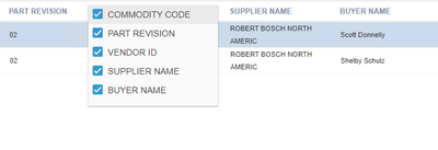

On right clicking column heading in grid, we can deselect certain columns. We expecting the selected columns to be save until it is changing manually in UUser Interface. But Once I reloaded the page, the grid columns are resetting back and displaying all columns.
How to save selected columns of Grid in UI.?

Could you please tell Thingworx version and which grid (New Grid - 9.4, Grid, Advance Grid) used mashup?
Also if possible post some screenshot
/VR
Thingworx version is ThingWorx 9.1.0-b10877
Widget - gridadvanced
If I unchecked columns names in grid, on refreshing page the changes should remain same.

Unfortunately, this cannot be achieved because you won't get selected/unselected columns as output in runtime.
But you can make use of configuration JSON to unhide/hide columns based on user/user selection.
For example :
In this example based on the selected type, grid columns will vary
You can achieve something like this
More about Grid Configuration JSON - Configuring the Grid using JSON Data (ptc.com)

With 9.3, PTC added a new grid widget with cache runtime changes, column order, column sizing, and column visibility.  It would be a good idea for you to upgrade given the fact that the version you are running is no longer supported.
