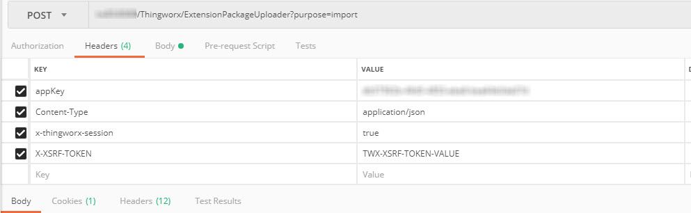

Edit :
Here's how it looked for me in Postman
