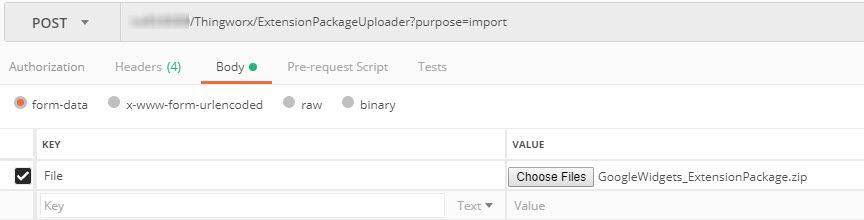

Here's how it looked for me in Postman
Hi @supandey,
We were able to get the postman request to work but we are having troubles with the curl command.
