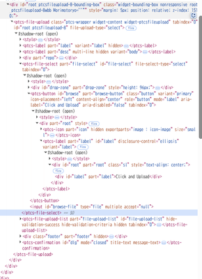

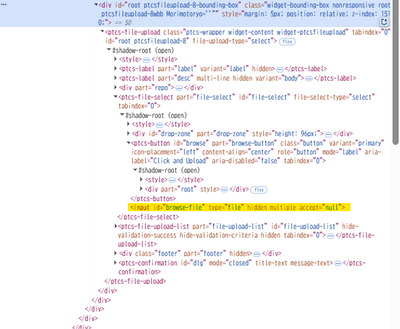

I'd like to edit default HTML automatically when Mashup open like from before to after below, because my device seems like don't accept "button" , but can accept "input" directly.
Is there an easy way to achieve this, or do I need to learn more advanced skills, such as creating a custom widget?
Thank you for reading.

You can't influence/update HTML directly because it is generated by the widget, you would have to create a custom widget for this.
RM_13784781
(To:Rocko)
Thank you for answering my question.
I'll try to create a custom widget for this.
