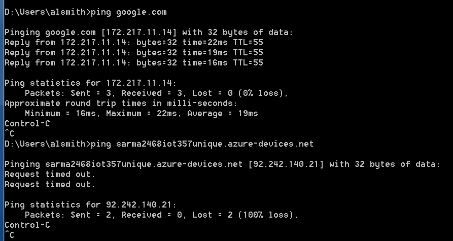

Can you ping your hubHostname? If you can not ping it there is a networking our Azure issue

Could you please help me how to ping to hubHostname?
Open a command window and type the command ping followed by the host you want to test. Below you can see Google responding.
I also tried pinging your IoT hub and I got a domain resolution to an IP address which is a good sign it is set-up, but it did not respond. I don't know if the free Azure account allows IoT hubs, or if there is some network restriction on the Azure side that prevents me from connecting
