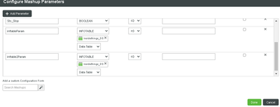

@CaShimiz ,
What parameters do you have defined to you child mashup?
  • TAG   (string)
  • descrip  (string)
  • Sts_on   (boolean)
  • Sts_stop  (boolean)
  • initTable   (infotable)
  • initTable2 (infotable)
What information is being passed to the collection widget?

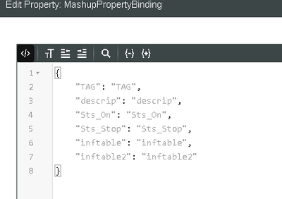

What does you "MashupPropertyBinding" look like?
 "TAG" : "TAG",
 "descrip" : "descript",
 "Sts_on" : "Sts_on",
 "Sts_stop" : "Sts_stop",
 "initTable" : "initTable",
 "initTable2" : "initTable2"
Let me know what you have and I will compare it with my test case

Parameters in my child mashup (All except inftable2 are binded to widgets) :

- And my bindings in the collection are these:

@CaShimiz
I have revised my test case to be closer to your question. I am using ThingWorx 9.1.0 for my testing.
I created a child mashup and parameter bindings:
With the Collection property "MashupPropertyBinding"
In my test case I used the Thing service "GetProperties" to return an Infotable. The Data Shape for the InfoTable is:
I used a different data shape for "inftable". When I bound the infotable to the grid it displayed the columns. Are you seeing the columns in the composer after binding the data source?
