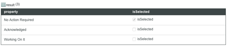

I have a service that returns a list in the following format: returned list with selectionreturned list with selection

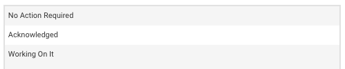

When I use it on a mashup with a list item, the "selected" item is not displayed upon list loading.Screen Shot 2019-03-05 at 18.24.10.png
loaded list, no selectionloaded list, no selection
How can I make it so the list initializes with the selected rows returned by my service?
I managed to make my list select a row using my "isSelected" property through the use of a validator and an expression.returned infotablereturned infotable
validator checks it isSelected is truevalidator checks it isSelected is true
if isSelected is true, expression takes selected propertyif isSelected is true, expression takes selected property
selected property is set as selectedText in listselected property is set as selectedText in list
list with specific selection on loadlist with specific selection on load
However, this only works for the first row of data returned by my service, is there a way to iterate over the returned data in the mashup so that my validator checks all rows of returned data?
