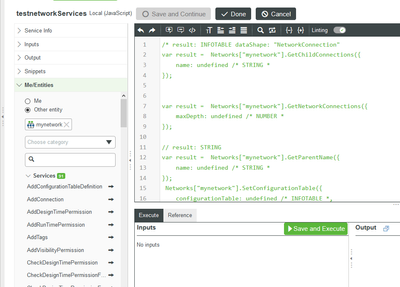

I do not think is possible to modify a network structure after it was created from code, but you can check the available services for Network Entity (Snippets > Other Entity > <NetworkName>  ), maybe some of them will help you:
