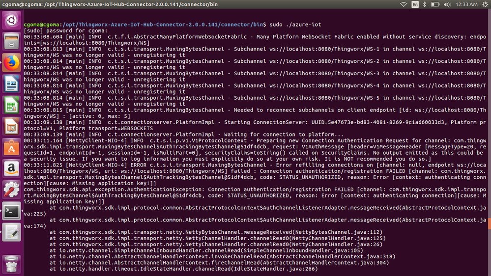

I am following the resource guide
https://developer.thingworx.com/en/resources/guides/azure-iot-hub-connector-quickstart
to connect between azure iothub and thingworx.
I am using the setup as follow, I have connection server and the thingworx foundation install on the same machine.
I have edited the config file of connection for azure as well as thingworx foundation. I have added the appKey and thingworx host and port in "transport.websockets" section
transport.websockets {
// ThingWorx platform application key
app-key = "0d277e85-944d-4e85-8ec6-2c16a903c74e"
// One or more platforms can be specified here, comma separated
platforms = "ws://192.168.43.77:8080/Thingworx/WS"
But when I am running the connection server using the precompiled I am getting the error as shown in screenshot
Please let me know if running connection server and twx foundation on same machine is causing this issue.
Let me know if someone faced similar type of issue.

We are able to connect between TWX an Azure, but we are using TWX 8.5 and IoT hub connector 3.0.
Configuration method is different for IoT hub 2.0 & 3.0.  It will be helpful if you share cxserver log file also.

Hi @cgoma
I can see Application key error in log file, so please check your application key and expiry date as suggested by @Constantine
/VR

Constantine
(To:cgoma)
@cgoma You'll get the same error if the app key does not exist, double-check if it is correct.
/ Constantine
cgoma
(To:Constantine)
@Constantine
I did not find any issue with the application key. I double checked it and I had used the multiple application key.

slangley
23-Emerald II
(To:slangley)
Hi @cgoma.
From your duplicate post, we noticed that you were trying to run version 3.0.0 of the Azure IoT Hub extension on ThingWorx 8.4.  These versions are not compatible.  Your previous screenshots in this thread, however, indicates 2.0.0.  Please clarify which configuration you are having issues with.
It might be easier to work through the issue via WebEx.  For that, we will need to open a case.  I'll be happy to open one on your behalf once you provide your PTC Support contact info.
Regards.
--Sharon
cgoma
(To:slangley)
@slangley
I am trying to use azure IoT hub connector 2.0.0 with ThingWorx 8.4 on Ubuntu.
But the issuse that my ThingWorx 8.4 works when Java OpenJdk is installed.
Also for azure IoT hub connector only java oracle. There is clear mentioned that azure IoT hub connector wont work with Java OpenJDK. Also when I am trying to use thingworx 8.4 with oracle java, thingworx is not working properly.  I am getting attached error log when using thingowrx8.4 and oracle java.
