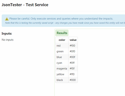

I was trying with this JSON File, Colors.JSON:
		"color": "red",
		"value": "#f00"
		"color": "green",
		"value": "#0f0"
		"color": "blue",
		"value": "#00f"
		"color": "cyan",
		"value": "#0ff"
		"color": "magenta",
		"value": "#f0f"
		"color": "yellow",
		"value": "#ff0"
		"color": "black",
		"value": "#000"
I tried this code and this worked for me. I have downloaded and installed the Parsley Advanced Parsing Extension
var params = {
	path: "/Colors.JSON" /* STRING */
// Get the JSON file in the System Repository, return type is JSON
var Content = Things["SystemRepository"].LoadJSON(params);
var params = {
	minDateMilliseconds: undefined /* LONG */,
	dateFormat: undefined /* STRING */,
	json: Content /* JSON */,
	dataShape: "DataShape1" /* DATASHAPENAME */
// result: INFOTABLE
var result = Resources["Parsley"].ParseJSON(params).array;
My Output was:
		"color": "red",
		"value": "#f00"
		"color": "green",
		"value": "#0f0"
		"color": "blue",
		"value": "#00f"
		"color": "cyan",
		"value": "#0ff"
		"color": "magenta",
		"value": "#f0f"
		"color": "yellow",
		"value": "#ff0"
		"color": "black",
		"value": "#000"
var params = {
var params = {
My Output was:
