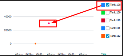

As shown below, Tank-108 is selected, which has the Legend color Blue, but as per the LineChart, it is showing Pink.

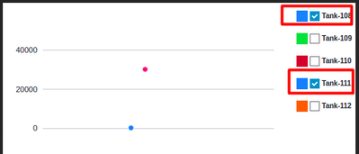

As you saw below Screenshot, the Legends colors are duplicated if the NumberOfSeries Property in the LineChart Widget is set to Auto
Thingworx Version: 9.3.2

@PEHOWE ,
You are right to a certain point, instead of removing the Specification color in the data provided, we removed the default color assigned to the Series in the Style Properties of the Chart, that solved the issue. Due to Default color assigned to chart, there was a duplicity in the colors.

@PEHOWE ,
Yes, trying to specify color, if the legend shows one color and in the Chart the line of another color, that will cause much confusion to the user/client.
Shashi.
@Shashi_Preetham
If you remove all the color specification from the data being provided to the chart. Does the chart draw with a single color for each item?
I will see if I can get a test case and review the issue.
@PEHOWE ,
