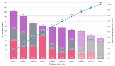

I am not sure about your exact requirement, but did you check Pareto chart in ThingWorx 9.1?

I have tries pareto it works! But didn't try on line/bar chart in 9.1

Can you please explain what issue you are facing with Pareto? Pareto is basically a bar and a cumulative line that is being calculated automatically. if you are looking for a bar and a line together then this can not be done with the new web component-based chart (line and bar). You can try the legacy label chart.
Pareto:

@mnarang yeah okay i will try with label chart
