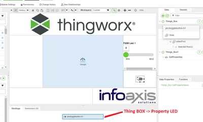

I looking for a way to send a boolean variable to my microcontroller.
I try to linked the Property Thing LED1 to Toogle Button, but isn´t work.
How I can link the Toogle Button with Toogle Button?

Hi, @PaiChung !
Thanks for aswer me!
Trying to do yours steps but isn´t work, like printscreens.
The refresh updating, I just doing in Gauges, it´s easy and I believe doint it as same way.
The first step is just implement the Bollean Variable to Toogle Button.

I do not see the use of a Mashup Parameter in your wiring. Currently I'm just seeing you bind your getpropertyvalues to the toggle and then to the label. With this approach you won't be able to do a getter/setter functionality the way I described it.
Hi, @PaiChung .
I try to attach the STATE OF TOGGLE BUTTON in my LED1 PROPERTY by Bollean Variable, from my Thing named Box.
I wanna do the arrow flux
