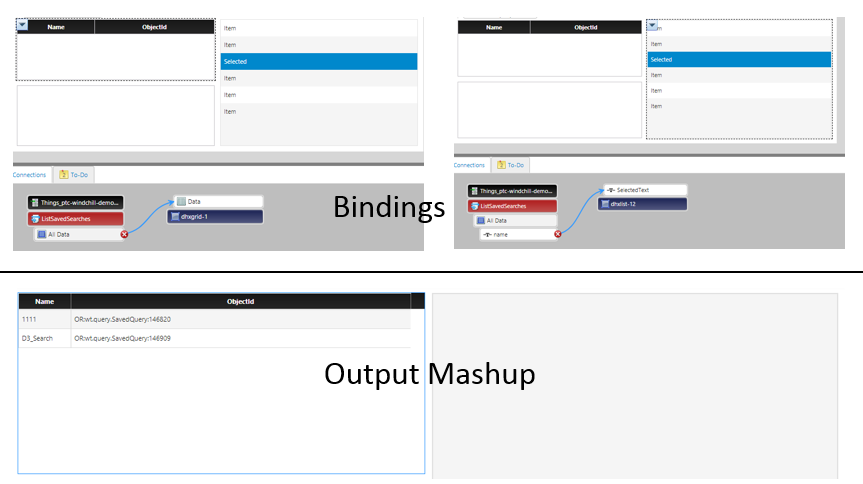

I have created a List widget and Grid widget, bound with ListSavedSearch (from Thingworx-ptc-windchill-demo-thing).
Grid widget is showing the Name and Object ID from my windchill saved search.
But List widget is not showing the list of names from my windchill saved search.
Please suggest.

What is your List widget configuration (bottom left)?

for list widget you had to mention DisplayFiled & ValueField properties under properties section of list widget
