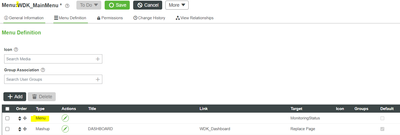

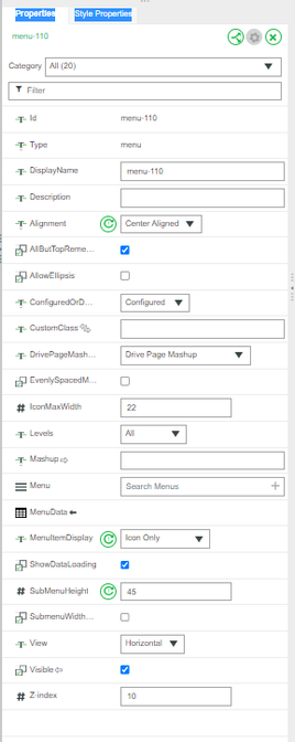

Make the settings as follows:
Then you will be able to achieve following
