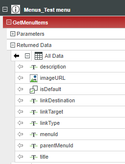

Service is binding with All DataService is binding with All Data

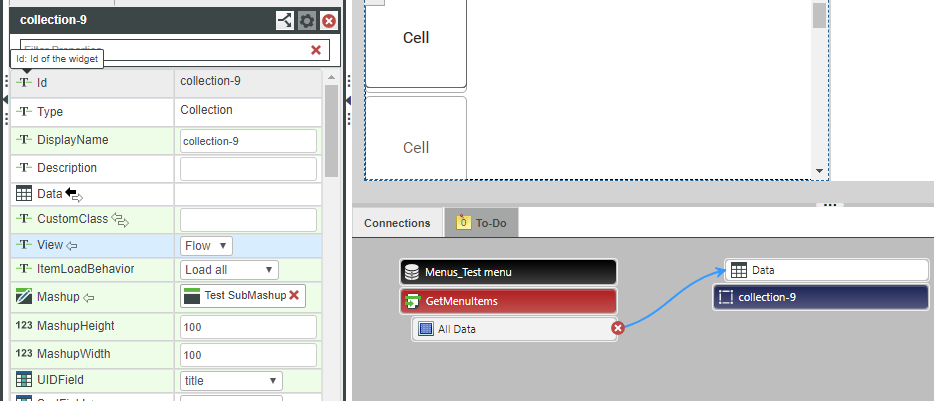

Collection widget binding, showing connection to sub-mashupCollection widget binding, showing connection to sub-mashup
"title" to "title" mapping"title" to "title" mapping

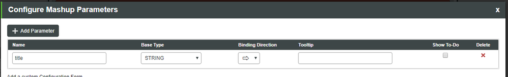

Sub-mashup parameter configSub-mashup parameter config

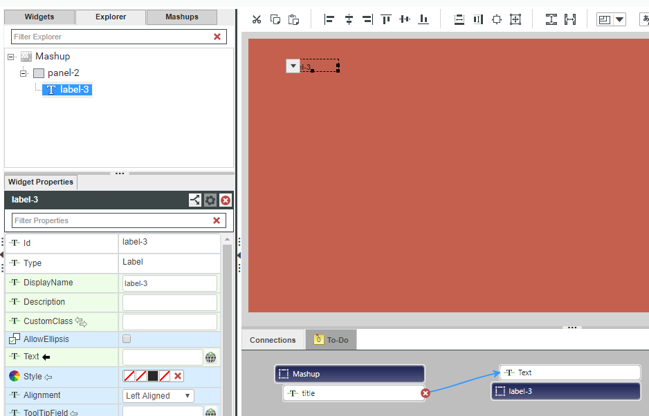

Mashup parameter bound to labelMashup parameter bound to label

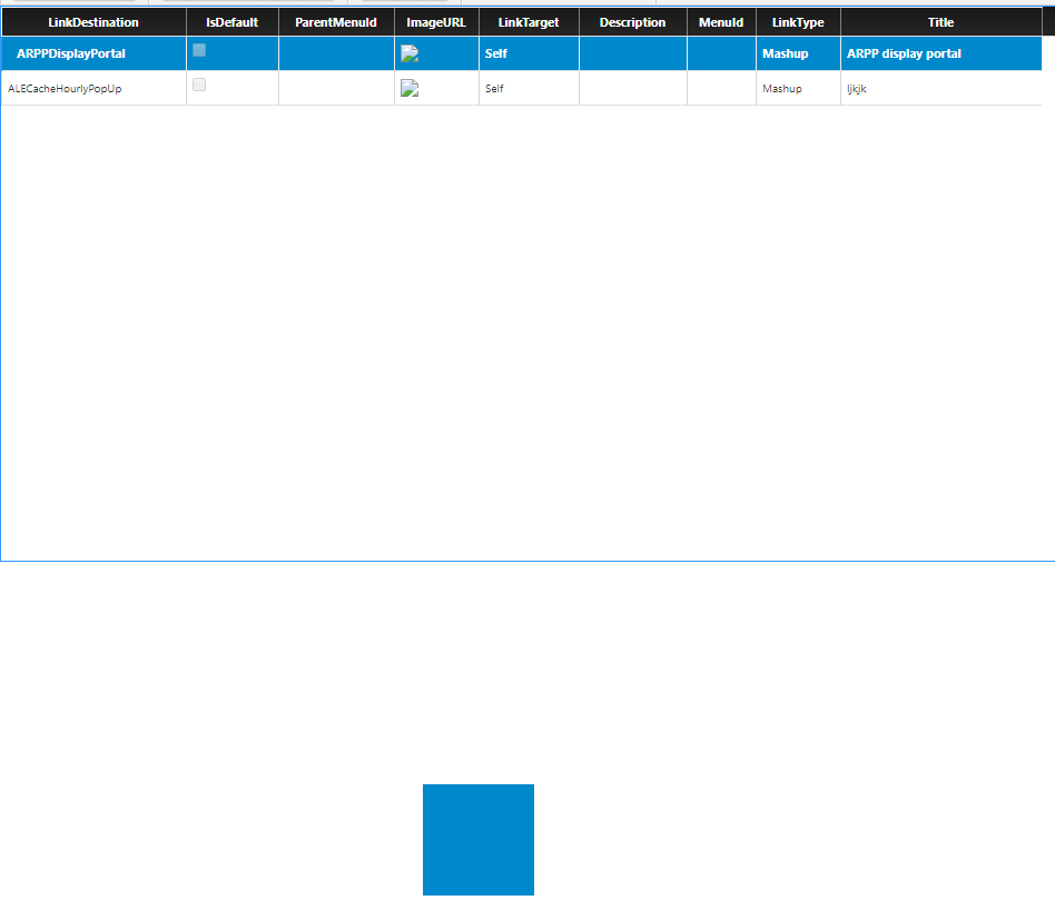

Rendered mashup. Shows two records returned from service, and one selected mashup below in the collection widget.Rendered mashup. Shows two records returned from service, and one selected mashup below in the collection widget.

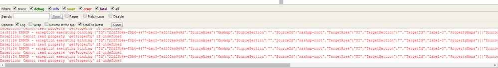

Errors shown.Errors shown.
14:58:24 ERROR - exception executing binding {"Id":"22df3b4e-f5b6-4477-bec3-7ad102aa949d","SourceArea":"Mashup","SourceSection":"","SourceId":"mashup-root","TargetArea":"UI","TargetSection":"","TargetId":"label-3","PropertyMaps":[{"SourceProperty":"title","SourcePropertyBaseType":"STRING","TargetProperty":"Text","TargetPropertyBaseType":"STRING"}],"isBoundToSelectedRows":false,"SourceDetails":"AllData"}
Exception: Cannot read property 'getProperty' of undefined

Also double check the datashape, I do believe 'title' lower case is correct, but perhaps in the datashape it is returning 'Title' instead. Not sure if title would be a 'reserved' word, you can always try changing the mashup parameter name to something like mashupTitle.

Tried with GetEffectiveMenu, same error. I am also running as an administrator, and can see the data being bound in the grid above. I can also see that there are multiple cells in the collection widget, showing that the data IS actually bound to the collection.
I did confirm in the datashape that title is lower case. I did try with "Title" and didn't have any success.
Changed the param to mashupTitle and had the same error as well.
