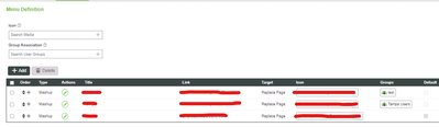

I have a menu with a user group assigned to each menu item as follows..
There are no users in the test group, and only a few users in the tampa group. However, I am still able to see these menu items in the UI when I sign in. I have tried non-admin user's as well as admin. All users can still see these menu items. What is wrong here? Shouldn't these items be restricted to the user within these groups?
This is version 9.0.4

okay. It should be working like this. Not sure exactly if Admin will see all entries anyway (I assume so) - but you mentioned you checked with none admins.
I am not sure if there maybe an issue in the TWX version you reference.
But to make sure: Could you validate again that you reference the correct menu? As I also already debugged some stuff but noticed that I checked on the wrong entitiy.
JO_9930585
(To:nmutter)
I am referencing the correct menu. I even unbound it and rebound it to make sure it wasn't a weird bug in TWX. My test user that I just created doesn't have any permissions and is not associated with any groups, yet this user still sees the menu.
could you call
result = Users["yourTestUser"].GetGroups()
in a custom service and check the result if only the expected groups are present? just to make sure that its not inheriting groups from somewhere.
JO_9930585
(To:nmutter)
This was the issue. The user is a part of a user group called users when created. However, users is in the administrator user group. Thanks!
