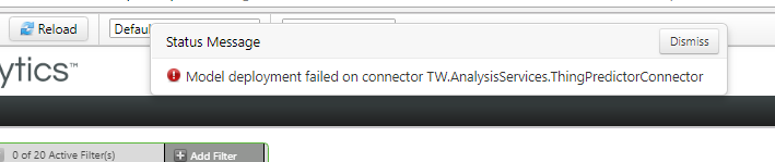

Helloo community ,
i tried to follow this tutoriel  ( https://developer.thingworx.com/resources/guides/analytics-builder-quickstart
i build the model but when i try to publish it i get always the same error message ( Model deployement failed on connector TW.AnalysisServices.ThingPredictorConnector ) .
i will be thankful if someone can help

Thank you for posting on the Developer Portal.
Have you had the opportunity to review this Knowledge Article from our support portal?
https://www.ptc.com/en/support/article?n=CS269545
Please let me know if that resolves your issue.

Thank youuuu , i changed the ports in predictive-standalone.yml  and restart ThingPredictor.jar
