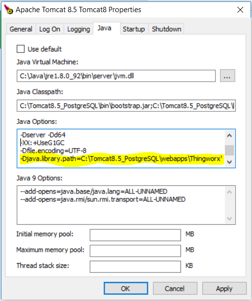

Was this java library path statement added to the Java options for Tomcat?  It would be a path similar to this:
-Djava.library.path=C:\Program Files\Tomcat 8.5\webapps\Thingworx\WEB-INF\extensions
Here's a screenshot:
Regards.
--Sharon
Yes. Added this path.
