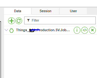

I am facing an issue that Services are hidden in Data tab as in below image. but all bindings are there and working as expected but it was sudden change and i am not able to see the services also i tried to add new service but still its hidden . Please help me to resolve this.
Are you seeing this behavior only with a specific mashup or across all the mashups?
Have you tried with other browsers?
Sachin
Hi @SachinSharma ,
I am facing this with specific Mashup not across all mashup . I tried on other browser but still its not working.
regards,
Vaibhav
Please try following steps and see if it fixes the issue,
1. Make a copy of the mashup and also take an export of it.
2. Delete and reimport the mashup and check if the services are visible or not.
Sachin
Can you try removing the thing from data tab and save the mashup. Edit the mashup again and add the Thing\service in data tab and see it works.
