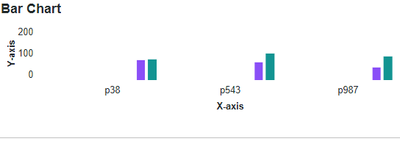

Hi
can we display bar values on each bar in Bar chart/Label  chart . should be responsive. please see below snap.

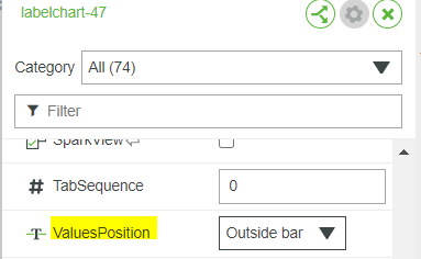

Hi @VaibhavShinde
Your property value: ValuesPosition should be set to Outside Bar in Label Chart as in below screenshot:

Hi @suverma ,
Can you explore it . how we can show values on top of bar as i am seeing like below chart and hovering on bar will show values but instead i want to show on top of bar.

Hi @VaibhavShinde
Hi @suverma ,
I got it, i had other extra columns in infotable which binds to bar chart . i removed those and working fine now.
