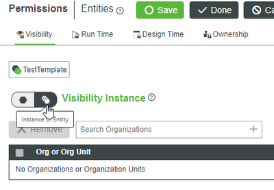

You may check the docs. In general you need to differentiate: Runtime permissions and Visibility permissions. (There are also DesignTime permission but they are mostly for composer editing stuff).
- Visibility: Who can see the asset? Visibilty can only be assigned for Organization(Units).
- Runtime: What can the user do with it (which services can he execute)? Runtime can only be assigned for Users or UserGroups.
For inheritance there are "Instance" permissions, like ThingTemplate visibility instance permissions. If you give UserB thingtemplate instance visibility permissions for both thing templates, he can see all Thing instances of this ThingTemplate. User A you only give instance visibility permission for ThingTemplate A.
Giving Mashup runtime service execute permissions will only apply for the mashup-entity itself. Not for items referenced in the mashup. So this is not what you want.
