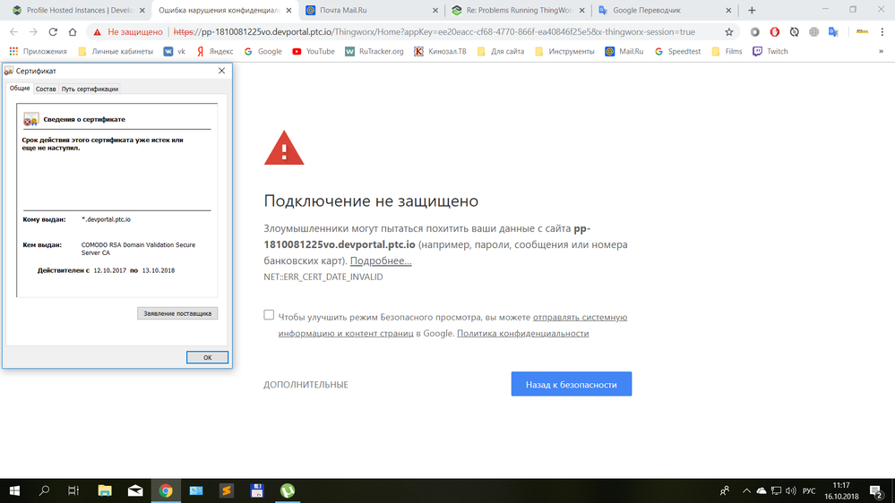

Hi all,
A user is having difficulty with the server. The server is running, but a white window appears at startup. Seeking recommendations.

Looking at the browser I can see that the https protocol is used. Next to the left of the url I can see a red warning.
It's just a wild guess but it could be that the user didn't accept the self signed certificate from the browser (he should be able to do so by clicking on the red text next to the url and following the popup instructions).
If this isn't the problem taking a look at the tomcat logs might give some further details, especially errors and access requests.

I also experience this issue. Seems like the SSL certificates of the hosted server instances expire after 3 to 4 days (for me it was after the weekend - came back and nothing worked anymore).
Why in the world is the 30 days trial only equipped with a 4 days certificate?
Please, can we figure out how to renew the certificates? This is unused exploration time...
Thanks, Josch

This is not quite true as you can see in the following snapshot from the certificate information page in my browser connected to the hosted Thingworx instance:
You seem to issue a wildcard certificate for the devportal.ptc.io domain.
So it is indeed an issue of the hosted server.
Best regards, Josch

Hey Josch,
To clarify, the SSL certificate was not equipped with a 4 day certificate. We used a 1 year SSL certificate that happened to expire on Friday October 12th. You can still access the server by accepting the expired certificate. We expect to have a new certificate at the end of business today, and a new template for these servers configured tomorrow. If you would prefer to have a new server provisioned once the fix is deployed I can delete your existing server and allow you to provision a new one.

Hey everyone,
I just wanted to clarify any questions and/or issues in this thread.
The SSL certificate for the hosted servers expired on Friday October 12th. Servers created before Friday should not experience this issue, but all servers created on or after will.
As Sharon mentioned we should be receiving our new certificate by the close of business today. We'll have a new template deployed by tomorrow. This will not; however, fix currently affected servers. You can still access these servers by accepting the unsigned certificate.
If you would prefer to have a new server provisioned once the fix is deployed you can respond to this post with the associated email address. We will have to delete and then provision a new server for the account. I would suggest exporting the entities and data for your existing server on the following page https://developer.thingworx.com/profile/hosting to preserve any existing work.
Brandon

Hey everyone,
We were able to deploy the latest configuration to existing servers to include the new certificate. Occasionally the update can take some time, and potentially a restart of your server, to take affect.
If your server is still experiencing issues please reach out to twx-devzonehelp@ptc.com and we can take a look.
