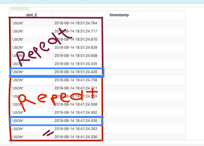

I have 8 JSON properties on a Thing and each of them representing a big cable of temperature sensors and each 8 of them stores 24 temperature readings.
Now when I want to query those properties, I see bunch of duplicate rows with different timestamps.
When I looked closer to it, I realized that duplicate rows are because those 8 cables updating themselves in random order, and each time when a cable updates itself, the other cables also getting a time stamp and that causes abnormalities when I QueryNamedPropertyHistory.
I dont know what s the optimum solution for querying the history of a JSON parameter, but I need urgent help about this.

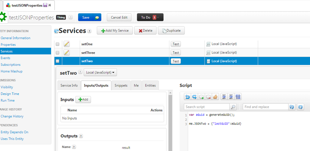

I can not duplicate the issue you are seeing.
I created a GenericThing, assigned a ValueStream, and added three JSON properties that are logged. I created 3 different services to set a random value for each of the properties and exercised the services to set properties two and three with the 'Test' button in Composer. When I run the QueryNamedPropertyHistory with the Test button I get the results I expect, no changes to property one.
I would look into the service you wrote to be sure it isn't updating all the property values. The timestamps are 50-80 milliseconds apart which seems about right for being triggered by an outside service and not internal.

I do pretty much like what you describe, and yes values are not changing, however, every time I update a JSON property, other JSON properties are also getting a new time stamps which causing duplicate values (with different timestamps) when querying named property history.

Can you demonstrate the issue using services no more complicated than the one below?
Hi @Rick-Stanley
I just tried what you said, and I couldn't replicate the problem either and that s what I was expecting TW to work in our case too. However, problem continues on our production server right now.
