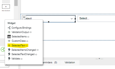

In that case the selectedItemsChanged event and the Selected Text would be bound to a service called e.g. "GetSubcategories". That service would deliver the right set of values for the second dropbox. The result of the service would be bound to the dropbox.

Please try with dropdown property of 'SelectedText'.

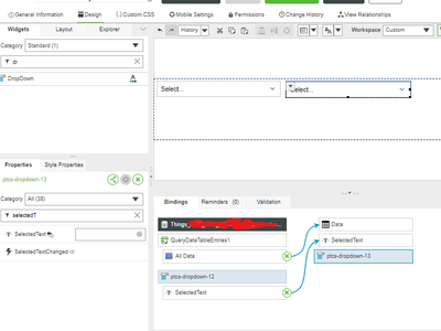

Ok thanks, which property should I bind using the drop down property
Binding should be like the below image.
Property - SelectedText from source Dropdown 1 to SelectedText of destination Dropdown  2.

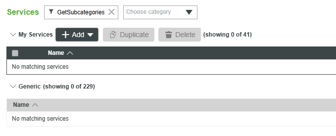

where should I find GetSubcategories?I can't find it here.
No that's a service you will have to write. There you provide the right values based on the selected categories.
