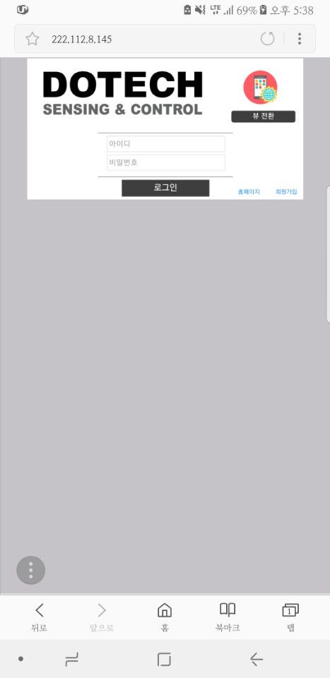

Hello
I do not like the login popup to appear.
Some mashups have been accessed via the guest account's AppKey.
But there were some unexpected issues in the mobile environment.
First, the session is not maintained as the URL changes.
If you access the mashup in the form of "Thingworx / Mashups / MonirotingService? AppKey = 2ee27c9a-eb20-4231-8bd3-c3ss29cs690 & x-thingworx-session = true", the URL will change like this:
'Thingworx / Runtime / index.html # mashup = MonirotingService & appKey = 2ee27c9a-eb20-4231-8bd3-c3ss29cs690 & x-thingworx-session = true'
The problem arises here.
The format of Thingworx / Runtime / index.html # mashup will also ask the user for credentials, even if they include an appkey.
In other words, after accessing the mashup via the AppKey in the mobile environment, the login popup will appear when the Internet browser (Chrome) is closed and then accessed again.
Tomcat's web.xml, index.html will be modified so that the session will be retained after a while.
But there is less time to stay
So I think there are three solutions.
1. The URL format does not change.
2. Thingworx / Runtime / index.html # mashup format Also, you can not ask for credentials by using the appkey.
3. Thingworx / Runtime / index.html # mashup format allows you to automatically request credentials
Is it possible to do the above three things?
If not, what else would be better?
Thank you.
1. Success access mash via appkey

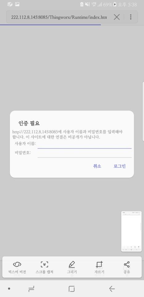

2. force quit browser(or reboot mobile)

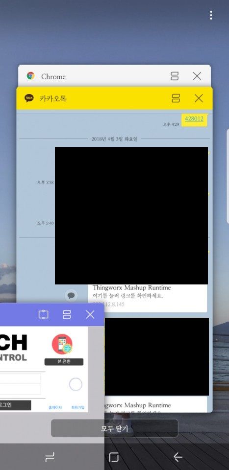

3.If you then run the browser again, it will automatically move to the previous url.
Where url is the first url used with the appkey.
However, the login window is displayed as shown in the picture.
