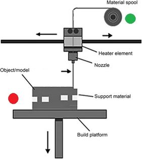

We are having a mashup with Image and shape. Please refer below,
Here Green and Red are shape widgets placed on top of Image widget. The mashup tree as follows,

As we know field set is kind of panel so that is static. But, we are in need to make responsive mashup with image and shape widgets. Is that possible? any workaround there?

The only option I'm aware of is use the 3rd-party SVG widget (https://github.com/ptc-iot-sharing/SvgViewerWidgetTWX) which allows manipulating SVG content in runtime. In this case you'd have your shapes embedded in the image, and will be manipulating their color via "data" infotable associated with it.
Note that this widget is not supported by PTC and was last updated a few years ago, so if anything goes wrong you're on your own.

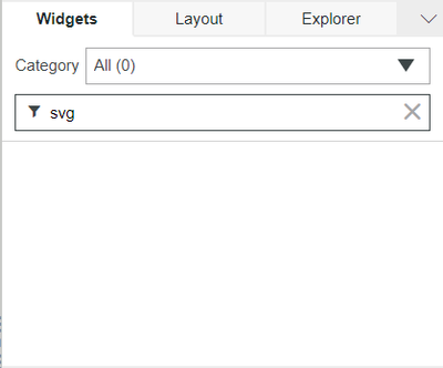

I tried to import into Thingworx 9.3.7 and it's successfully imported. But, not able to view the SVG Viewer Widget in Mashup.

Are you sure you reloaded the page after importing the extension? I tried on 9.3.1 and it works:

Somehow, restarted the Thingworx instance and able to see now. Let check with actual usecase. Thanks.
