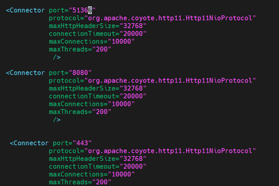

I have installed the Thingworx on 8080, but I want to run it on 443, 8080 (HTTP) and 51366(HTTP).
I have changed in the server.xml, but it fails when I add two more connectors:
Output of Catalina.out

This was a Command issue, it looks like below command I was using is not giving full access to start the Thingworx:
sudo /opt/ThingWorxFoundation/tomcat/current/bin/startup.sh & sudo tail -f /opt/ThingWorxFoundation/tomcat/current/logs/catalina.out
I tried with the below command, and Thingworx started:
sudo systemctl stop ThingWorx-Foundation.service
sudo systemctl start ThingWorx-Foundation.service
