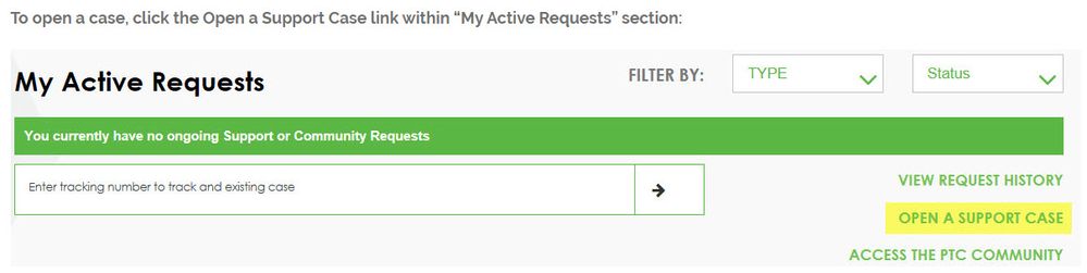

It seems that you will require more in-depth investigation and support to determine the cause of your data discrepancy/unexpected behavior.  You can open a support ticket at: https://www.ptc.com/en/support/ .  The link to open a new support case is found mid-page.
Best of luck in resolving your issue.  It would be great if you could return to this thread and post the final resolution.
