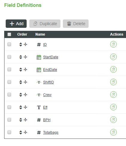

Newb and first time poster.
I am creating a service that calls a stored procedure in SQL Server*. It uses the JDBC connector. The results I see when testing the service don't match what is returned when executed on the SQL Server. Some numbers are completely missing, presumably because of their format? If I change the query to return random integers in the Eff column, then I can get results back. It doesn't seem to matter if I bind my output to a data shape or just to text.
Thanks in advance for any tips.
* it doesn't matter if I am calling a stored proc or running the code in the service. Same result.

Thank you.  Would you be able to share with me a screenshot of exactly how you're invoking the stored procedure in your ThingWorx instance?  I would like to see how you've wrapped the call and what your input/outputs look like.  Also, would you mind sharing the details of the datashape you're assigning to the result?
jbaute
(To:aregal01)
I've tried two ways of executing the sql - using the code above, pasted in directly to the service code window, as well as
Exec <stored proc>
SAME Result
I also get the same result using an Infotable data shape or TEXT in the output. However, attached is a screenshot of the datashape.

Thank you for the response/screenshot.  On the surface it seems that you have things structured correctly and are invoking properly.  It is possible that ThingWorx is sanitizing the SQL Query text as it's ingested from the stored procedure.  I'm going to do some further research on this topic and I'll get back to you with my findings.  Thank you for your patience while we work through this issue together.
