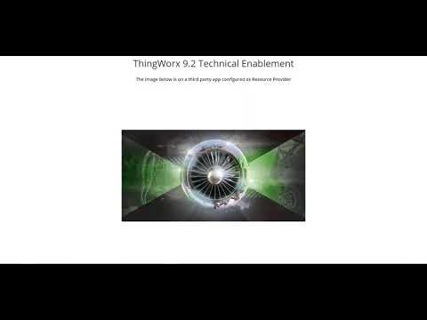

So I came up to this thread
https://community.ptc.com/t5/ThingWorx-Developers/User-Provisioning-Exclusion-List/m-p/841719/highlight/true#M60360
and the tutorial PTC gave (Youtube video; https://youtu.be/4rNNAzH0yp0?si=Beys6F6BUijHNPEw).
tldr; when SSO is enabled, can't the login using Administrator/other users in Thingworx (at least on that thread and Youtube video).
My goal is, I just curious if I can give the option to login via SSO or Thingworx Users when SSO is enabled, or is it not possible to do so?
If not possible when SSO is enabled (like on the references I attached),
I have an idea to differentiate the Authenticator for users to login based on SSO or non SSO, how can I do it?
So on the landing page there will be one option that handle Thingworx Users login (as default when SSO is disabled) and one option to login via SSO that maybe display popup form (or such) and after the user logged in from SSO auth page, it is automatically logged in to the application too.
