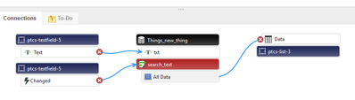

I have placed textbox on top of list widget.I want to search item using text box in list widget.what serivce to write for searching items on textchanged event

I've done this with Text field widget (ptcs-textfield):
1.  I have a list with the names of the Things on the platform using Generic Thing template
2. Create new thing with a service (search_text) that is querying the things

I have used 'Like' query with service QueryImplementingThings service.
3. In the mashup, create the bindings: txt from search_text bind with Text of textfield, Changed event of textfield bind with search_text service, All Data of search_text bind with  List data.
And done, when typing something in the textfield, you will get data in the list; you can adjust the query per your requirement.
* with the widget textbox , you need to hit Enter after typing to get data in the list, so I have used in above example ptcs-textfield widget.
Hope it helps,
