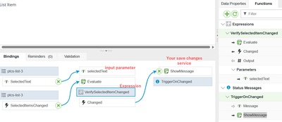

I have thingworx 9.6.5 cloud hosted.
On a mashup I have dropdown menu automatically populated and selected with the right value at page load.
Esample I have 3 options mode1 mode2 mode3, and at page load I populate the dropdown and select the last selection (ex mode3).
I also use the SelectedItemsChanged event, in order to update the selected value with a service, whennever the dropdown is used.
The problem is that at page load, when it auto-select the last value (SelectedText input property of the widget), it launch the SelectedItemsChanged event and so it saves that first selection as a change ... but this is not needed and cause some problems.
I know if I use an external SAVE BUTTON instead of the events I could solve .... but I would it saves changes directly when dropdown is changed.
Is there a best practise to to that ?

Hi @iguerra,
As @MA8731174 commented, you can use Expression function.
Expression function has Changed event, which will fire when an input parameter of the expression changes.
Bind the SelectedText of the List widget to the input parameter of the Expression.
And make sure to set Fire on First Value = false (which is the default setting) so that the first value passed to the expression's input parameter will not fire this Changed event.

I was using the SelectedItemsChanged , and not the SelectedRowsChanged of the service populating the dropdown.
The SelectedTextChanged is firing anyway, probably because from "nothing" it selects a specific element, so it seems not to be a solution

Hi @iguerra,
