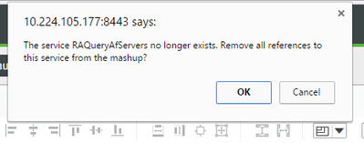

I've imported the .xml file which includes services our developers provided. But when I view the mashup which utilizes this service, this error pops up:

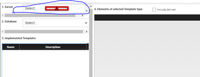

And the mashup becomes like this:

Hi @lizhaori
It would look like your developer forgot to add some entities in the export or that some configurations steps are needed (possibly permission).
You could edit the mashup and locate how this field in error is coded to see if it relies on an entity that is possibly missing (entity which in turn would hold the service).

Thanks Chris, I'm asking our developer to check this part
